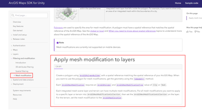

I don't understand the description.
I implemented the feature in UnrealEngine with blueprints, but I don't know how to implement it in Unity. Here is my attempt in Unity, unfortunately it fails
Can you tell me the correct code steps?
Thanks!
