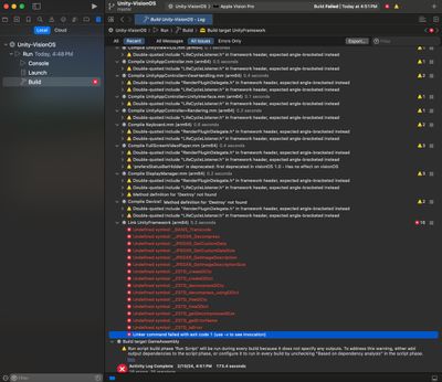

Thanks! That worked in getting the project to build to the Vision Pro, although the map didn't show up (placed map inside of Volume Camera, seemed way too big for that, but I positioned the map for the terrain to cut through the volume, just to see if it would work). Eventually I played with too many variables and got these errors from the XCode side.
