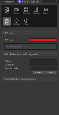

I have an API key, as shown in the first image. I have all the code copied. Both the map component and the camera are successfully created, but the map itself doesn't show. The inspector for the map component doesn't show the basemap, elevation, or layers either, as shown in the second image.
I have also tried using the map creator UI and samples and gotten similar results, making me inclined to believe that the issue is with my API key or request. When I check the developer credentials, it also says that the API key has had no usage.

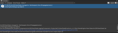

Hi, I am having the same issue when using the map creator UI (I have not tried the API method). I can confirm I cannot load any of the sample scenes: I am getting a "no viewport" error in every case.
The following link tells me that means "there is not a valid camera, viewport properties, or spatial reference" but I fail to see how that can be the case even in the samples.

In every case I am getting the same error, with no map data being loaded:
