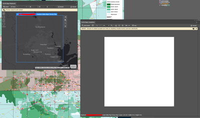

I am receiving an error that I have not encountered before. I have a map file that needs to be consistently updated - this includes syncing new data layers. I'm attempting to sync a new thematic layer, however when I open the compilation window, I am receiving the following error:
Error: Amount of Content Exceeds Sync Limit, try disabling complex layers
It's also strange that none of the existing content in the map file, or even the layers window, is displayed now:
I'd like to be able to sync new/updated layers to this map file.

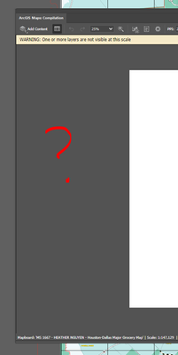

I can't even get the layers panel to display in the compilation window:
It's strange because I just synced a data layer last week in this same map document and didn't have any issues.
