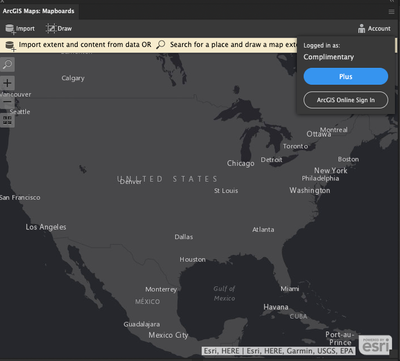

Yes, I can see both the mapboard panel and the compilation panel; see attached screenshot.

Yes, I signed up for complimentary access a while back. I also set up a trial learning account under another email (shirine.pont@gmail.com) yesterday to see if I could get there with that one. No joy there either.

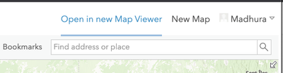

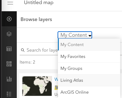

I didn't try webapp builder method but there is a new 'print' capability in ArcGIS Online via the 'new' Map viewer. I think it might be useful to explore this. When you sign into arcgis.com you can use the Map tab and then open the new map viewer using this button if it doesn't open by default. In the tools panel (left) you should be able to Print the map to a graphic format. There are few options to choose from PDF, SVG, AIX. Note: PDFs and SVGs might not have the same organization as AIX. Also note to open an AIX file, it requires the extension & an ArcGIS account with Viewer, Editor, Creator or GIS Professional license. You can check license info under my settings when you sign into ArcGIS.com. I did a quick test with a PDF and this layer, the map downloads with the ACLED layer via this print tool. Here are the steps again.
1. Sign into ArcGIS.com and choose Map
2. Choose new Map Viewer if not open by default
3. Add ACLED layer from Browse layers
4. Print either map or layout.
