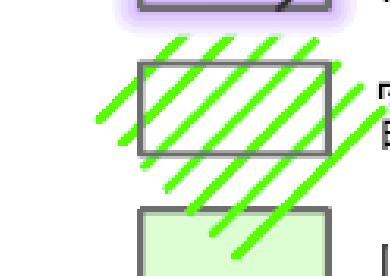

When symbols created using the following procedure are output to AIX, they do not display properly as shown in the attached image.
Is there any workaround?
1. add polygons to the map.
2.Open the symbol window and go to [Properties] → [Layers].
3.Change "Solid fill" to "Hatched fill".
4.Add a legend to the layout view and output to AIX.

@ShihoY Thank you for using Maps for Adobe for your design work and reporting the issue. We are able to reproduce the bug in-house. A solution has been found and the fix will be available in our next release of the application, which will be coming soon.
Best,
Maps for Adobe Team
SarahBell
@ShihoY until the fix is released (very soon), the workaround for you would be to use the shape of the legend rectangle as a clipping mask for the pattern.
  1. make a copy of the legend rectangle path.
  2. Place the leggend pattern paths in a group
  3. use the copy of the rectangle path as a clipping mask See this link for details under "Hide Parts of Objects..."
