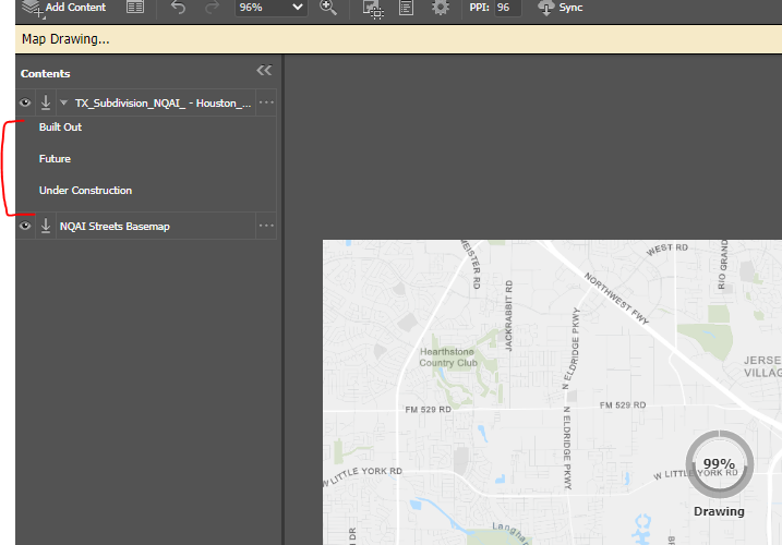

My question is this: Are feature layers that are symbolized in the "New Map Viewer" compatible with the Maps for Creative Cloud extension? We have had mutiple layers that have been symbolized in the "Visualization" tab of the layer details, and don't syncy/display symbology when added to a MCC project.
The layer can be added via the Compilation window, however the symbology is not recognized and the tool sgets stuck at 99% drawing:
Wondering if anyone is having similar issues? Since we are forced to set layer symbology in the "new map viewer" through the visualization tab, I would hope that this symbology would be supported in the Creative Cloud extension?

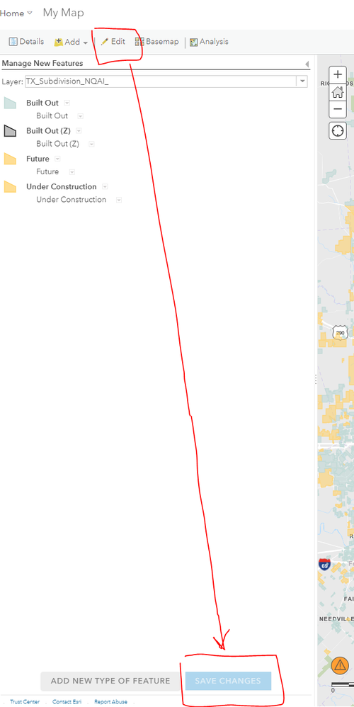

I've discovered a work around for setting symbology in the "old" map viewer, which seems to have fixed the problem.
- Open "old map view" and add the layer
- Set Symbology
- Click "edit"
- Click "save"
- This seems to save the symbology in the "old" style and allows it to be synced.
