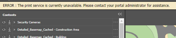

Hello, I use ArcGIS Maps for Adobe CC on and off. I'm currently on v 3.6.0 of the product.
Recently I've been getting an error when syncing map context to the Artboard from Map and Feature services in our 10.9.1 Enterprise Portal. My typical workflow is to sync all layers in a single internal basemap map service to Illustrator and then share this with peers that need to do custom Illustrator work on our basemap. So I've used this service many times over the years.
ERROR: The print service is currently unavailable. Please contact your portal administrator for assistance.

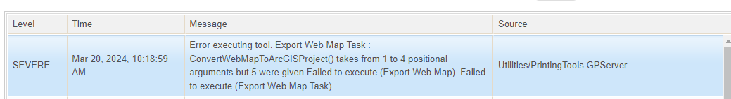

At the same time, ArcGIS Server is throwing this error.
I have seen some related posted about the error that points to an ArcGIS Pro version issue and that it is related to Pro 3.2. We are running Pro 3.2 and we routinely republish this service as updates and new layers are added.
Error executing tool. Export Web Map Task : ConvertWebMapToArcGISProject() takes from 1 to 4 positional arguments but 5 were given Failed to execute (Export Web Map). Failed to execute (Export Web Map Task).

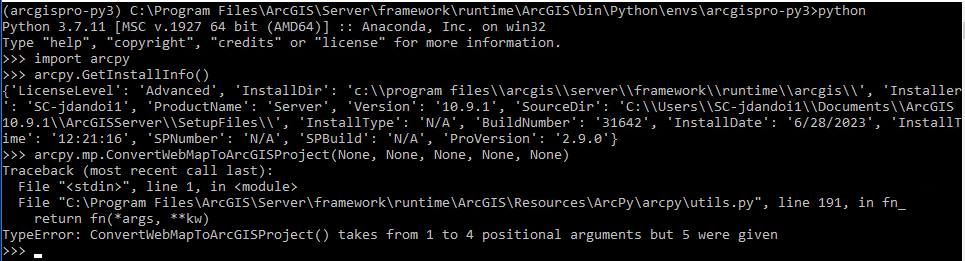

Executing the Python arcpy module installed with Enterprise 10.9.1 Server  on the Server does throw the same error that is logged when using the Creative Cloud Sync tool.

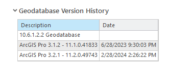

Your comments about the Pro version got me thinking though, and this reminds me that I DID upgrade the enterprise DB to version 3.2 11.2 last month. I wonder if this is causing the issue?  I've also been emailing with support and will message them about this as well.
It don't know if i can roll back the database, i am guessing no. So it sounds like i'll be planning out the upgrade to 11.1!
