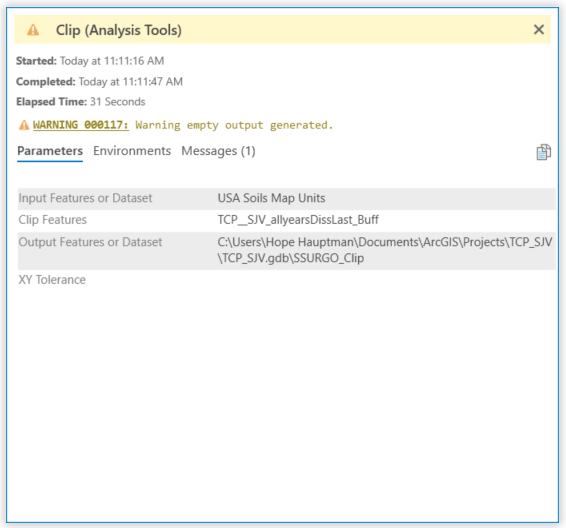

Thank you for your reply. Yes - that is exactly what I want to do clip the Living atlas layer but the living atlas layer does not seem to be 'clippable' so that is why I was searching for a downloadable raster or shapefile. I have tried using the clip raster tool with the living atlas layer but it fails (see image). Can you clip the living atlas layer?

I can clip the feature layer, but as I mentioned, I don't think you can do with w/ the Living Atlas' raster layers. I clipped the Soil Units feature layer without issue.

Yes I tried that too and it seems like it is working but it generates empty output...? Capture1.PNGCapture1.PNG

Try just selecting the soil units you want, then right-click the layer in Contents and click Data → Export Features. Does that work for you?
