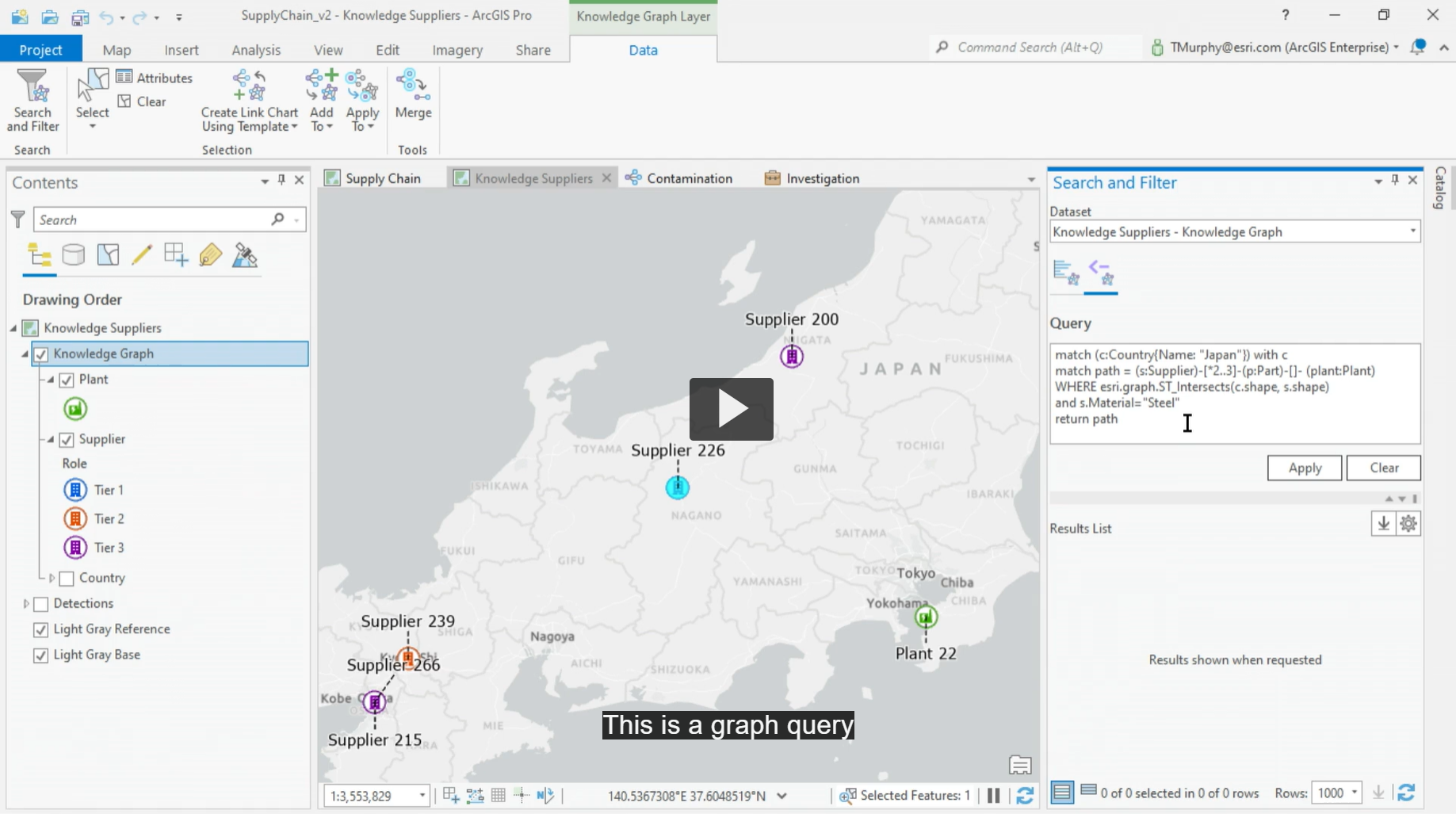

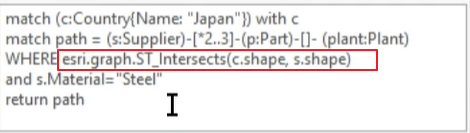

When I look closely at the supply chain demo shown at Esri 2022 developer summit(Plenary | 2022 Esri Developer Summit - Esri Videos: GIS, Events, ArcGIS Products & Industries), I noticed that inside the Cypher Query, it compares the spatial relationship between the two entities and returned the path that has the correct relationship(in this case, "Intersect").
The capability to query entities using spatial relations is a huge bonus when extracting information from the Knowledge Graph. However, when I was looking for detailed explanations regarding how this is done in the ArcGIS Pro help, I found nothing. I was wondering if anyone know where should I look?

@xingchenc Currently, supported spatial relation operators are esri.graph.ST_Equals(<geom>, <geom>), esri.graph.ST_Intersects(<geom>, <geom>), and esri.graph.ST_Contains(<geom>, <geom>).
For spatial utility, there is esri.graph.ST_GeoDistance(<geom>, <geom>) and for spatial construction there is esri.graph.ST_SKTToGeometry(string).
