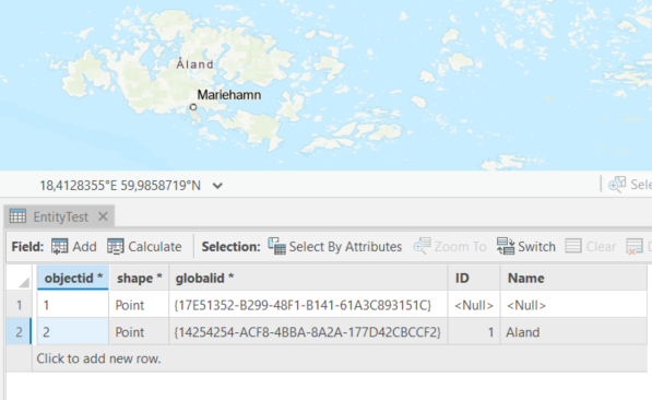

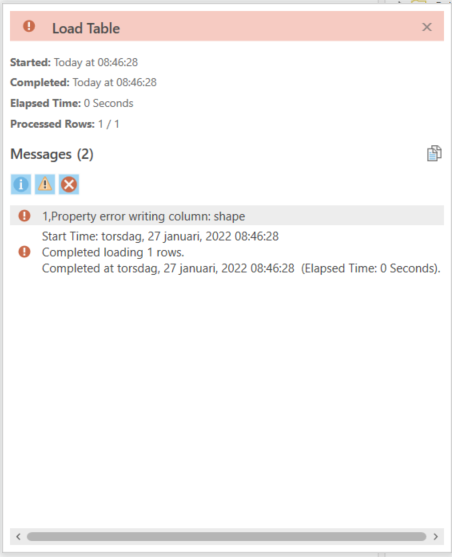

I´m excited to try out the new ArcGIS Knowledge. However, I ran into problems trying to import entities with shape through Load Table. I get an error during the import but the data is imported anyway. The issue is that the imported shape is not located on my map, I cannot zoom to the entity. The data is imported from a Feature Class in a File Geodatabase and the coordinate system is WGS 1984 (WKID 4326). Any ideas on this error or any thoughts on how I could alter the import to get the correct shape come through?
Error messageError message
Load table error message.

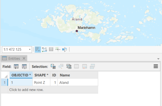

Imported entity in Knowledge, shape not visible in map.Imported entity in Knowledge, shape not visible in map.
Entity in ArcGIS Knowledge after import, shape not visible in map (row 2).
Feature class in file geodatabase, shape visible in map.Feature class in file geodatabase, shape visible in map.
Feature class in file geodabase, shape visible in map (co-located with Mariehamn).

Hello! Apologies for the late reply to your question. It looks like the shape in your feature class has Z values (SHAPE is 'Point Z') which are not currently supported in ArcGIS Knowledge.
