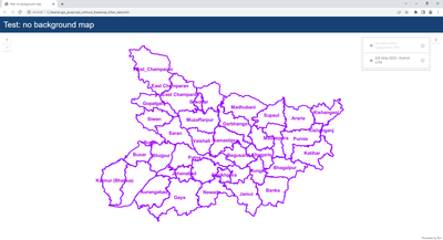

Hi @aggarwalarpit93,
Please see screen dump attached: your data in an application without a basemap.
I slightly modified your code (see below) and, next to the districts I also added the settlements, which will become visible when you zoom in.
Yeah, zooming in and zooming out is working fine.
And yeah, @Sage_Wall is right: you should use the scale instead of the zoom property.
HTH,
Egge-Jan
