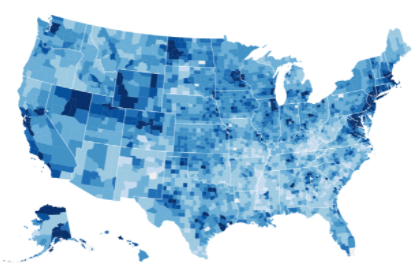

Hello, I have a csv file that has zip codes. I want to create a heatmap of the frequency of zipcodes in the csv file.
I would like to create something like:
Is this possible using the api? If so, can I get some help implementing this? Thank you!

You don't need the API for this. Assuming the data is suitable, you can just upload the file to a new map at ArcGIS.com and apply the heatmap style.
Here are some resources about this -
https://enterprise.arcgis.com/en/portal/latest/use/add-items.htm
https://doc.arcgis.com/en/insights/latest/create/heat-maps.htm
https://www.esri.com/arcgis-blog/products/arcgis-online/mapping/heat-mapping-in-two-simple-steps/
Shay
LaurenBoyd
Hi @BushraSyed1 ,
There is a sample that shows how to construct a HeatmapRenderer from a CSV file that may help you get started: https://developers.arcgis.com/javascript/latest/sample-code/visualization-heatmap/
And as @shaylavi mentioned, you can also upload the file to ArcGIS Online and add it as a layer to a map to apply the heatmap renderer style there. Hope this helps!
