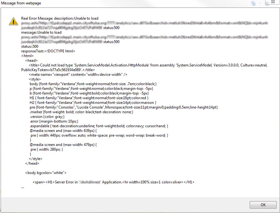

I started by getting an error, a javascript alert that said: xml [objectError]
So I broke it down until I could READ the error... I used the following code:
function objToString (obj) {
    var str = '';
    for (var p in obj) {
        if (obj.hasOwnProperty(p)) {
            str += p + '::' + obj
 + '\n';
    return str;
I passed the [object Error] to this function and got a MASSIVE error screen.
The web apps this error is happening are legacy and critical. They were also written by keyboard monkeys.

Never mind. Turns out it was a .NET issue. Fixed and corrected.
