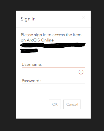

I am directed to this Sign-In page instead of our Azure AD login:
When I enter the portalURL in the browser instead, the Azure AD login page shows up. Does anyone see what I have to change to also make the application work with Azure AD?
