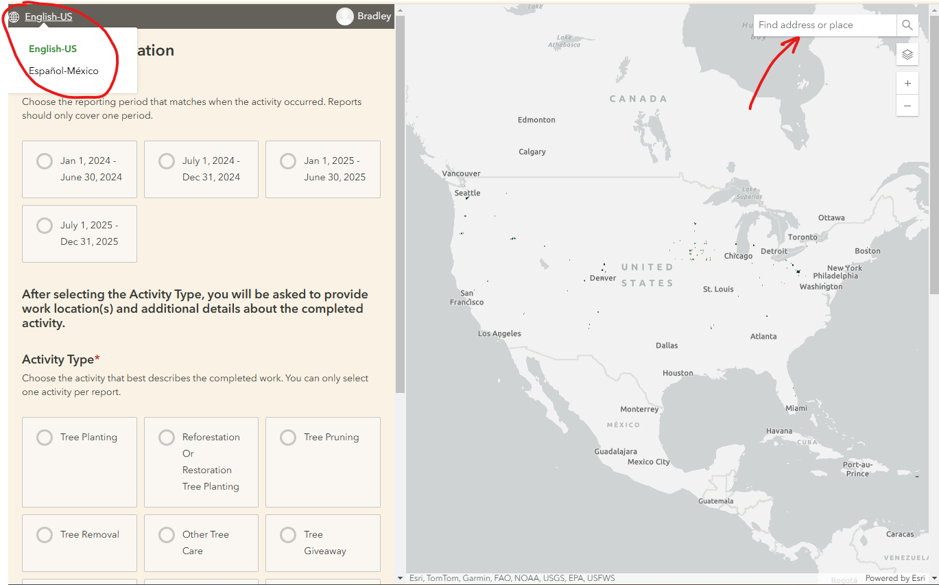

I am developing a React app using the following:
- ArcGIS JS Maps SDK
- Calcite
- Survey123 web app API
When a user changes the language (default en-US to es-MX) in the embedded survey, I need to change the language of the map's widgets, as well.
I created a simple codepen that should change the map/widget's language on button click, but I'm not seeing the language in the search widget, for example, update.  Any ideas?
intl.setLocale("es-MX")
https://codepen.io/bsnide/pen/gbYoxwE
Thanks!
