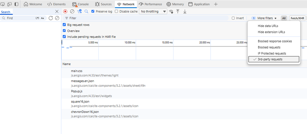

Out of curiosity, I double checked the network traces on an Portal-based Experience Builder app and also one of our JS SDK pages; neither application made any external requests other than those expected (i.e., js.arcgis for the Javascript map).
Could be that the observed call to arcgis.com is related to a late assignment of the esriConfig.portalUrl?

baohuachu7
I checked my application ,the request is from creating the Search widget.
baohuachu7
@CodyPatterson  @D_Atkins   Today I checked it again, this apears when “Search” widget was created. My SDK version is 4.23.
