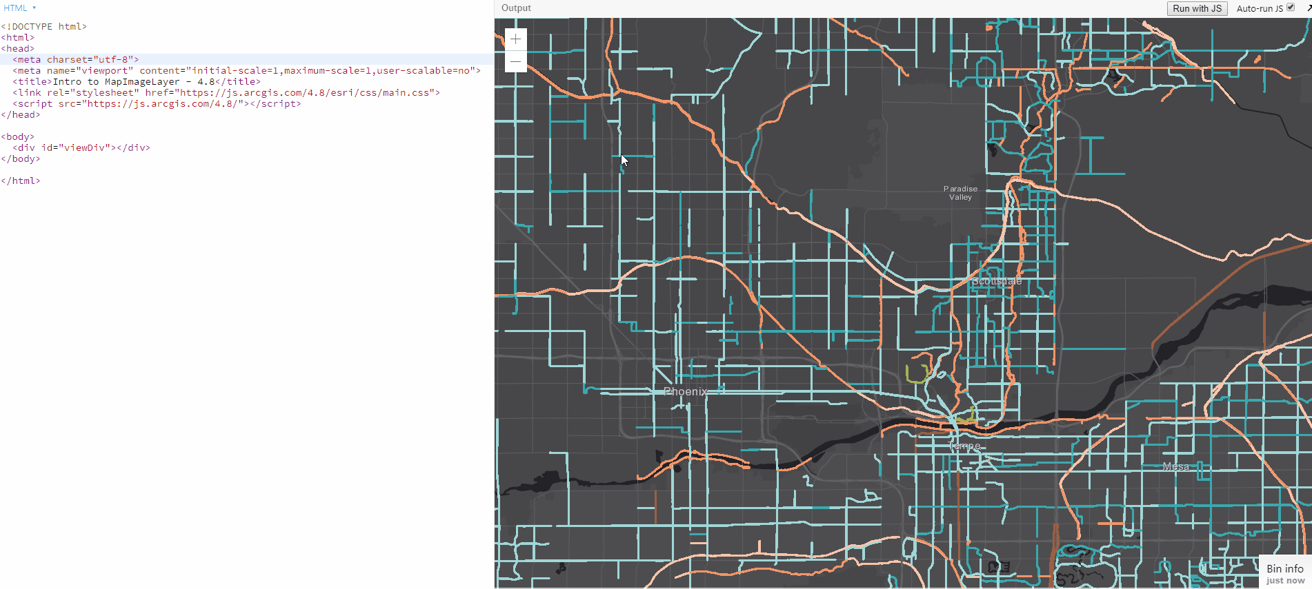

In my simple JSBin example, why aren't all layers from my arcgis rest endpoint being shown?
Simple JS bin example

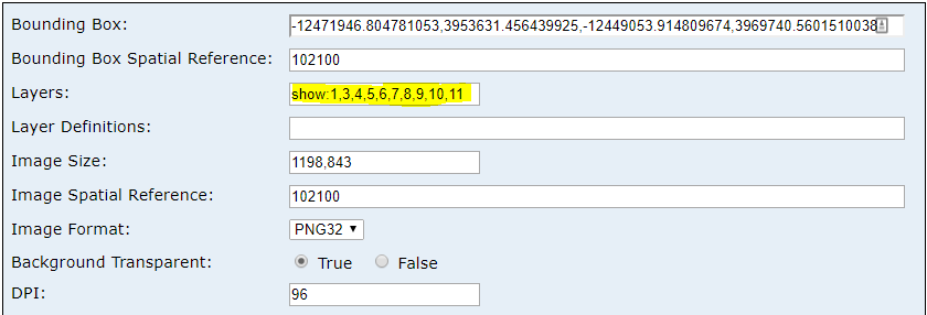

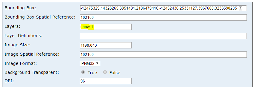

I noticed that if you change the ESRI JS API version back to 4.4, it works as expected:
I also inspected the network requests and compared the 4.4 api version to the 4.8 version:
4.4 Request
4.8 Request
For some reason, the "Layers" parameter doesn't seem to be correctly populated in the 4.5-4.8 version of the JS api.

It looks like maybe 4.4 was handling it incorrectly.
Looking at the service info, the defaultVisibility of all layers except for "Bikeways" is false, so 4.8 is displaying the layer correctly now.
https://geo.azmag.gov/gismag/rest/services/Test/BikeMap_Test/MapServer?f=pjson
You could iterate over the sublayers and turn them all on if you'd like
