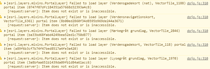

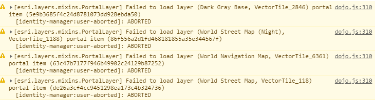

The console shows the following:
Note:when loading without locale defined it shows:
Notice the difference in language. For some reason it seems to ask for login when the locale is not danish (my default browser local), while just accepting that items are inaccessible if the locale if default danish.
