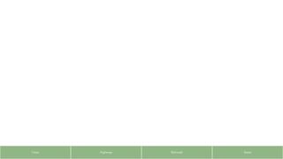

But sometimes during export task client sends in export task parameter layers=show:... and sometimes dynamicLayers={...json with defs...}. Same behavior in ESRI sample: https://codepen.io/dalasek/pen/BagPmKQ?editors=1000. See the network tab in Chrome developer tools, click butons in different orders and check behavior of export task request.
Steps:
1. click to Cities (layers: show:0)
2. click to Highways (layers: show:0,1)
3. click to Railroads (dynamicLayers: [{"id":4,"source":{"type":"mapLayer","mapLayerId":4}}]) ---WHY???
4. click to States (again dynamicLayers...)
