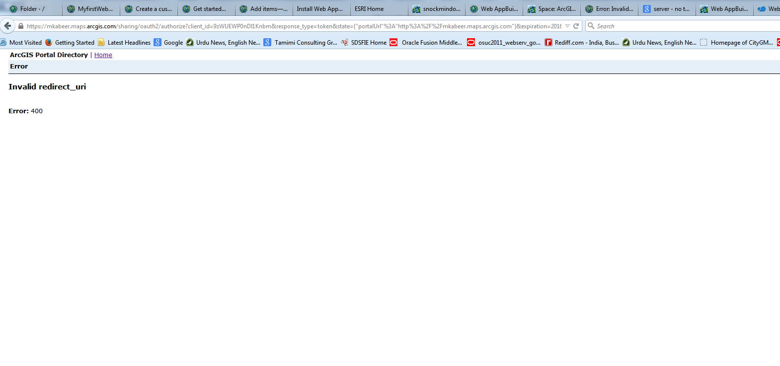

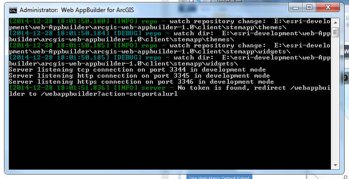

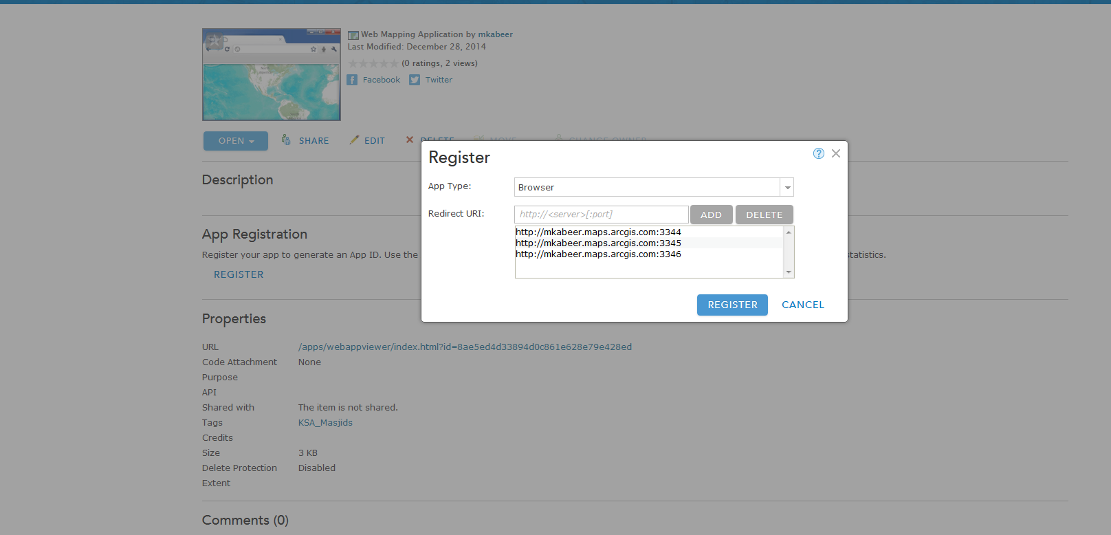

Dear Sir
i created new account and registered and working with webappbuilder online ( i can create feature layer, map and application) and i am registering this application also to get appID. but when try to run startup.bat from my local maching its giving error even though i give app ID what i created
here is the error log
would you please help me how can i run from my machine i am using windows environment with firefox
Thanks
kabeer
