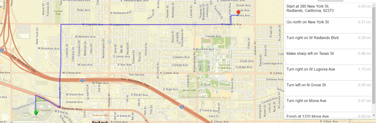

AdarshSharma
Actually i want to driving direction between two stop point using network analysis arc gis api for javascript. like this
