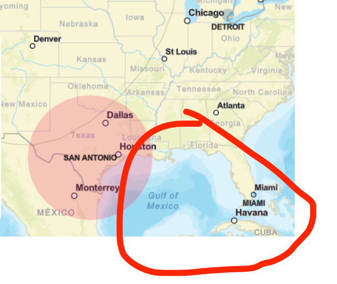

Hi everyone,
in my case, I added the scalebar to the mapview.ui. However, when I use MapView.takeScreenshot to export the current view, it doesn't include the scalebar.
Does anyone know how to add scalebar to the screenshot?

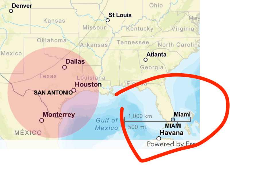

The takeScreenshot method only includes map elements, not widgets or other DOM elements.
https://developers.arcgis.com/javascript/latest/api-reference/esri-views-MapView.html#takeScreenshot
Some people have reported using html2canvas to capture DOM elements, but I haven't tried it with the Maps SDK.
