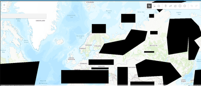

I'm trying to load features from a GeoJSON into the graphics layer by converting it to ArcGIS JSON and creating a graphic out of each feature so that I can edit them using the Sketch Widget. However, the features are blacked out and I'm not able to edit them. Is it not possible to edit features using the Sketch widget? I'm  using the Sketch widget to draw features on the map and I'm concerned about using the editor widget just to be able to edit features that were loaded from a GeoJSON file.

Here's how the features appear on the map:

You should not have to use the sketch widget to create new features in a GeoJSONLayer. You can use the Editor widget to create, update or delete features from a GeoJSONLayer. To use GeoJSONLayer with Editor widget, you must set templates property on the layer.
This simple test app shows how to set up GeoJSONLayer with Editor widget. You'll have to change to code to work with polygons. Another thing I should point out is that, at 4.18, you have enter values for all attributes fields or have to hit enter (without entering values) to get the Add button enabled after creating a new feature. We have an issue for that.
