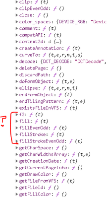

I  simplified the code for testing and was able to download a PDF (finally). These are the changes I made:
1. added dojo/domReady,
2. changed    new jsPDF()     to     new jsPDF.jsPDF()
3. updated the URL of the third party library to https://unpkg.com/jspdf@latest/dist/jspdf.umd.min.js so that it uses the latest version.
One other thing to note, is that in my original post i called doc.fromHTML() in accordance with the code sample i referenced. But when i take a look at the console log --> console.log("this is the doc: ", doc)  I do not see fromHTML(). So maybe that was just from a past version of the library? I am not sure, I could be reading the console.log wrong.
This is the Javascript code, hopefully it help point someone in the right direction.
