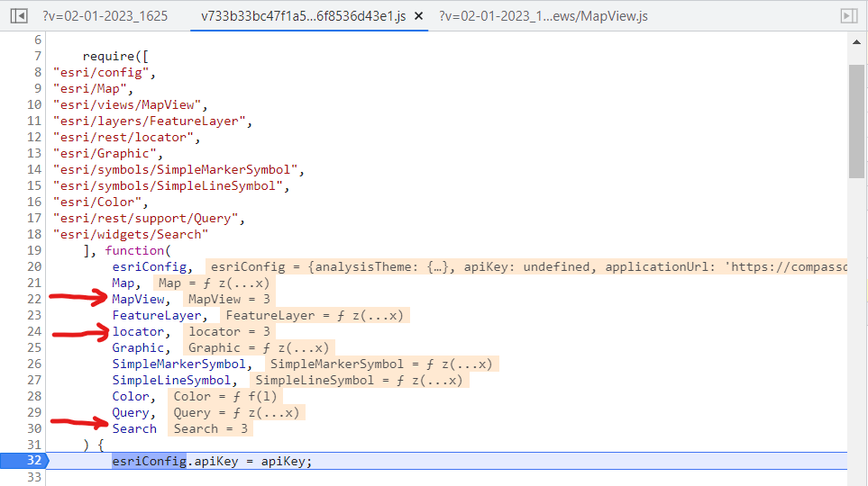

Has anyone been able to emit an ESRI map within a ServiceNow portal?
I have a map created by one of our GIS staff that uses the ESRI JavaScript API and works correctly as a stand-alone web page. However, ServiceNow portals are actually Angular 1.5 and manage all of the script includes. When the map emits in the ServiceNow portal, some of the ESRI modules are not initialized correctly (see image). Any input welcome.

Esri is currently developing a solution that integrates much of the functionality available in the ArcGKS SDK for JavaScript into ServiceNow. We are currently able to display maps, work with many of the renderers, perform geo-processing tasks, etc. Could you please provide a little more information related to your implementation. For example, screen shots, code examples, steps on how you are displaying the map in the ServiceNow portal. Are you specifically displaying this within the portal? I look forward to answering any questions you might have.
