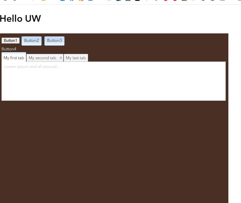

I am writing a simple HTML file with a map using Javascript 4.29.  We are tring to migrate our JavaScript 3.46 applications. The dojo code works when the map.js is commented out (see below).

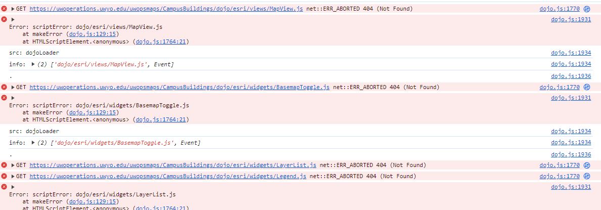

When i uncomment the map.js the dojo code breaks but the map will show up. I am getting these errors
here is the code:

@Mr_Kirkwood  You'll need to set up dojoConfig.packages. More info and an example are here: https://developers.arcgis.com/javascript/latest/4.25/#removal-of-non-esri-packages-from-cdn.

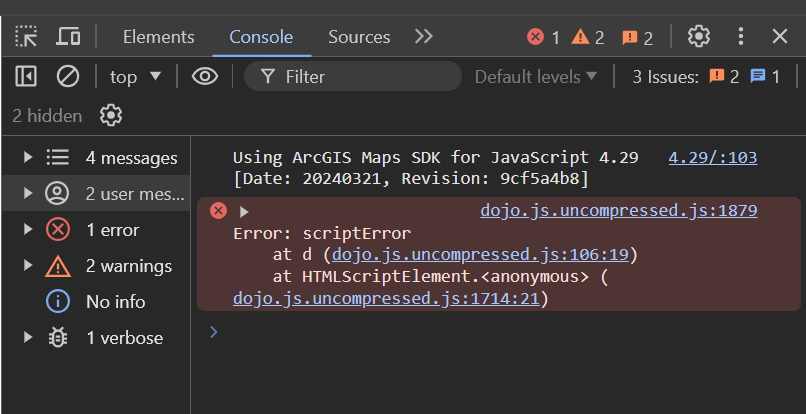

Hello @AndyGup, Can you please guide me on how to use Dojo with the ArcGIS API for JavaScript version 4.29? When I include Dojo using its CDN link, it gives me a script error.Here is my code
<!DOCTYPE html>
<html>
<head>
    <meta charset="utf-8">
    <title>Tutorial: Hello Dojo!</title>
    <link rel="stylesheet" href="https://js.arcgis.com/4.29/esri/themes/light/main.css">
    <script src="http://ajax.googleapis.com/ajax/libs/dojo/1.10.4/dojo/dojo.js" data-dojo-config="async: true"></script>
