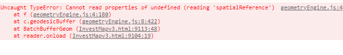

So I want to create a buffer around addresses (received via user upload) and extract aggregated data for them but I'm getting issues around the geometry() in BufferGeom(). Could someone please help me understand and resolve this issue?

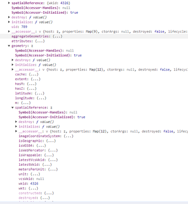

Charan
When i do console.log(d.value) I get a number and console.log(geo_points) i get:
