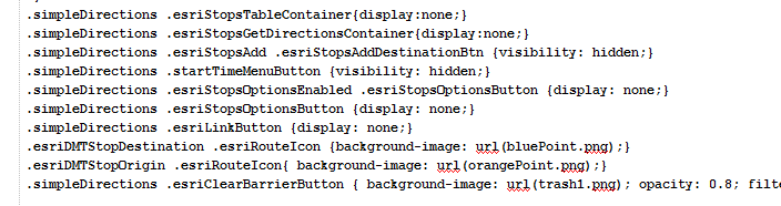

we have customized the direction widget to show only routes and we are not allowing the user to give the inputs by disabling the input stops using css properties.
it is working independently as standalone html page but it is not taking the css properties once integrated with Angular 4 application.(even setting !important also).
please help us on this, how to use css properties for ArcGIS widgets inside angular app.
