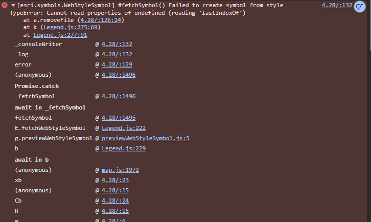

I am attempting to build a custom legend widget using the 4.28 SDK. I could generate all the standard simple symbols except for Web-Style symbol. The following is the code I used.
symbolUtils.renderPreviewHTML(new WebStyleSymbol({
  styleUrl: "https://cdn.arcgis.com/sharing/rest/content/items/1fbb242c54e4415d9b8e8a343ca7a9d0/data"
  node: document.getElementById('markerTest'),
Here is the error message
The error seem to have started at g.previewWebStyleSymbol @ previewWebStyleSymbol.js:5
I found that this code only works with SDK 4.32 or later. Any SDK earlier would, renderPreviewHTML will not generate html segement for the symbol.
