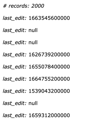

After the query I checked the field and it was a number. - line 57,
How do I keep the same field type?

This is the correct behavior.  Dates are returned as a number in unix time (milliseconds since 1/1/1970).  If you need to convert to a date, just do this:
new Date(element.getAttribute('last_edit'))

If you were to query using the REST API, you'll see you do get a number returned for the date field:
https://gis.cnra.ca.gov/arcgis/rest/services/Boundaries/CCED_AccessType/MapServer/0/query?where=1=1&...

Thank you for the reply.  I provided the above example just to demo my issue. Yes, I can convert it back to the date field as you suggested. However my actual case is an app where the user selects  a layer from a dropdown. Then, I have to access the selected layer's REST service. In the REST service some of the fields are classified as DATE and some are others are numbers. So, if I loop through the fields of the selected layer, all the fields are returned as numbers and I wouldn't know which fields are actually dates and which are numbers. Is there a way to distinguish the fields which are dates and which are not? Some of the layers have a lot of fields with a variety of field types.

You'd want to determine the field type from the fields property of the layer (line 46).  Your line 57 is just returning the object type of that attribute for the feature, which would be number since the value is in milliseconds.
