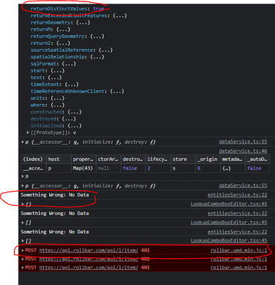

eyalj
When i change returnDistinctValues to true it says that suddenly i dont have any values,
