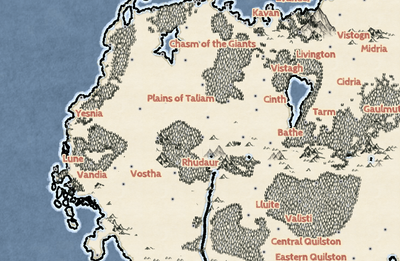

I created a fantasy world in ArcGIS Pro. I applied John Nelson's My Precious style to my project and I love the outcome. However, I want a dynamic map to share on my website. I struggled with the styling a lot and had to stray from the original John Nelson style for technical reasons. CIM in the JS API 4.x is just not quite there yet. Here are some sample pictures.
John Nelson's style in ArcGIS Pro:
Note the beautiful coastal lines that look hand drawn...

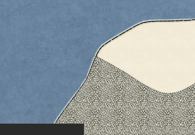

CIMGeometricEffect buffer or offset creates really jagged line effects. I was able to use that offset jagged effect to create the color gradient off the coastlines.
This is a quick screenshot of zooming into a coastline before the map re-renders. These lines

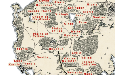

Here it is after it renders
