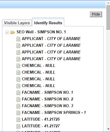

I created a tree and it is populating duplicate records. Here is a screenshot:
The records correspond to the amount of features identified. here is the code:

solution:
i solved this problem by creating a unique id (line 23):
