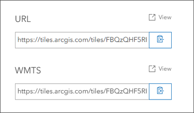

I did a quick search and am thinking this might be the layer you want to use (?):
https://www.arcgis.com/home/item.html?id=7254c77048444a45a5d41cf43445572b
If so it is a WMTS service and you'll find the URL down along the right side of the item overview page:
https://tiles.globalforestwatch.org/umd_tree_cover_loss/v1.8/tcd_30/wmts
If a different layer you are wanting to use, you'll still find the link along the right side of the item overview.
