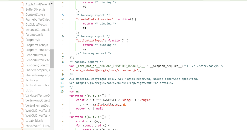

I am working on react application, where we have 2 mapviews (ArcGIS JS API 4.29) for side by side compare data to verify the changes.
Case:
In Left Map data is already loaded, and for right map loading the data on selection of dropdown list and initial 5-6 selection and applying on map, it is working perfect after that some times left map went blank(loaded layers not displaying) and sometimes rightmap went blank.. even i am loading data only on right side map.
When i check on console its shows the warning
Can anyone share to resolve this issue.
