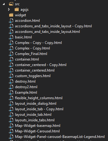

However, I made sure that the widget path is correct. It should be found. As shown above (image), My map is using one of my HTML. These are located in the same folder as  the '/src/agsjs' folder. It is pointing to the right place. I am not too sure what I am doing  wrong. is that '/src/agsjs' a wrong pointer when folder is located in the same folders as the HTMLs?

Basically, with that dojoConfig.paths object, you are telling DOJO that your /src/agsjs/ folder is at http://js.arcgis.com/3.10/js/dojo/agsjs/ .
This folder doesn't exist since ESRI does not host the TOC.
Two Solutions are:
1) You can host the API locally to avoid having to change the structure of your dojoConfig object
2) Change your dojoConfig object to point to the right location (easiest and recommended solution)
