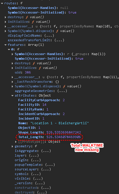

setDistanceToFacility(results.routes.features[0].attributes.Total_Length)
setTimeToFacility(results.routes.features[0].attributes.Total_WALKTIME) // this one is now undefined

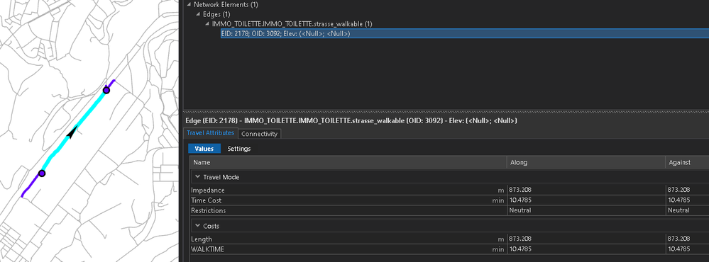

Since the updates the Total_WALKTIME attribute doesn't exist anymore, only TOTAL_Length. Hence we are not able to provide the time information to the end-users. I have checked the network layer in ArcGIS Pro and can confirm that there is still a WALKTIME cost.

In case anyone wonders, we were able to solve the issue. Since the update, it was necessary to define the method "impedanceAttribute" to be able to retrieve the WALKTIME.
const params = new ClosestFacilityParameters({
facilities: featuresetFacilities,
incidents: new FeatureSet({ features: [startFeature] }),
returnRoutes: true,
returnFacilities: true,
impedanceAttribute: "WALKTIME",
defaultTargetFacilityCount: 1,
