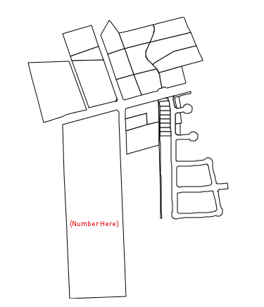

Hello.
Sadly the developer who started this project has quit, and I am desperately trying to get up to speed.
All I want is something simple. Should be one of the most common functions in mapping - to add text inside a graphic as shown. (The map is generated, i put the number in there using paint for purposes of this post)
But as soon as I define a textsymbol, the program bombs. I don't even have to do anything with it, just the var declaration kills it. (See near the bottom of the code)
I have "required"  esri/symbols/TextSymbol among others at the top of the script file.
The idea is to place the contents of the HCAD_NUM field from the shapefile near the middle of each plot. But I can't even get it to show a hard-coded "Hello world" anywhere on the screen.
Any help would be greatly appreciated.

RobertScheitlin__GISP
MVP Emeritus
Allen,
  You have added the require portion but each require need a accomplaying var:
function (Map, ArcGISDynamicMapServiceLayer, QueryTask,
  Query, dom, on, FeatureLayer, Color, SimpleLineSymbol, SimpleFillSymbol, SimpleRenderer, Extent, parser,
  Circle, Units, TextSymbol, LabelClass)

TracySchloss
Honored Contributor
To elaborate on Robert's reply, make sure they are in the same order!  This is a common mistake for new users.
When I was first learning, I put each variable on their own line to check that I had every one matched up.  It was easier for me to see where I'd missed one, or got it out of order.  You can always edit it back to one long line later.
AllenHoward
Thank you! 🙂
