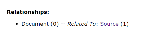

I have a feature service that contains a feature layer ("Management Regions") and several tables. The layer has a M:M relationship with Table 1 ("Source"), and that table has M:M relationships with the other tables.
When I add the layer as a FeatureLayer, I can see the Source relate using the relationships property. However, if I add the table as a FeatureLayer, its relationships property is null. Is there a way to get the relationships for the table?
