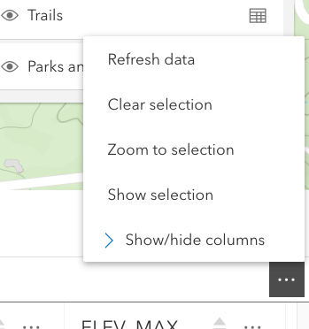

I updated the demo to allow the table to scroll. The demo app was only created to show ideas and isn't fully featured. Users can use the menu options to zoom to the map feature or to only show the selected features.
Also check out the FeatureTable SDK reference for more capabilities available on the table.
 Screenshot 2023-05-09 at 12.56.46 PM.pngScreenshot 2023-05-09 at 12.56.46 PM.png
