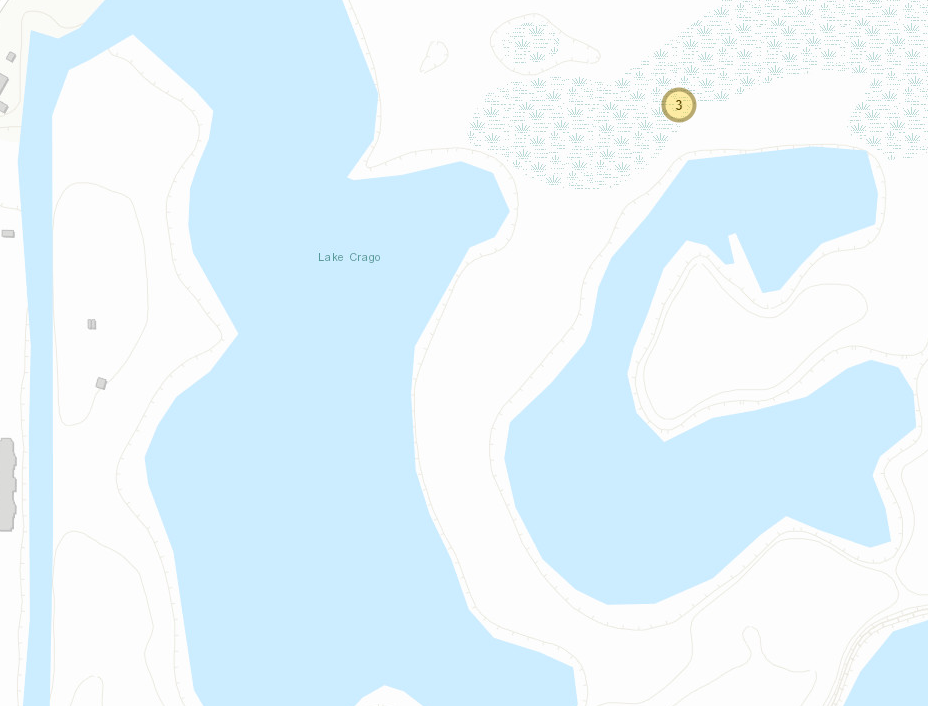

I am have Feature Reduction enabled on a layer and at some point when zooming in to a cluster it should break apart into single graphics. This does not happen for some clusters no matter how much I zoom in.
I tried changing the cluster radius, going as small as 20, but I get the same result. This appears to be happening for any cluster when the features are less than 1000 meters apart:
Here is the cluster as it appears in the app:

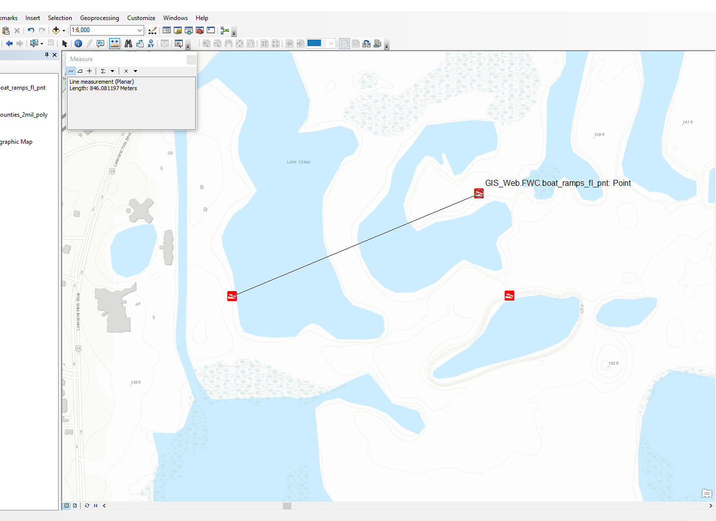

 Here are the actual features as they should appear:
