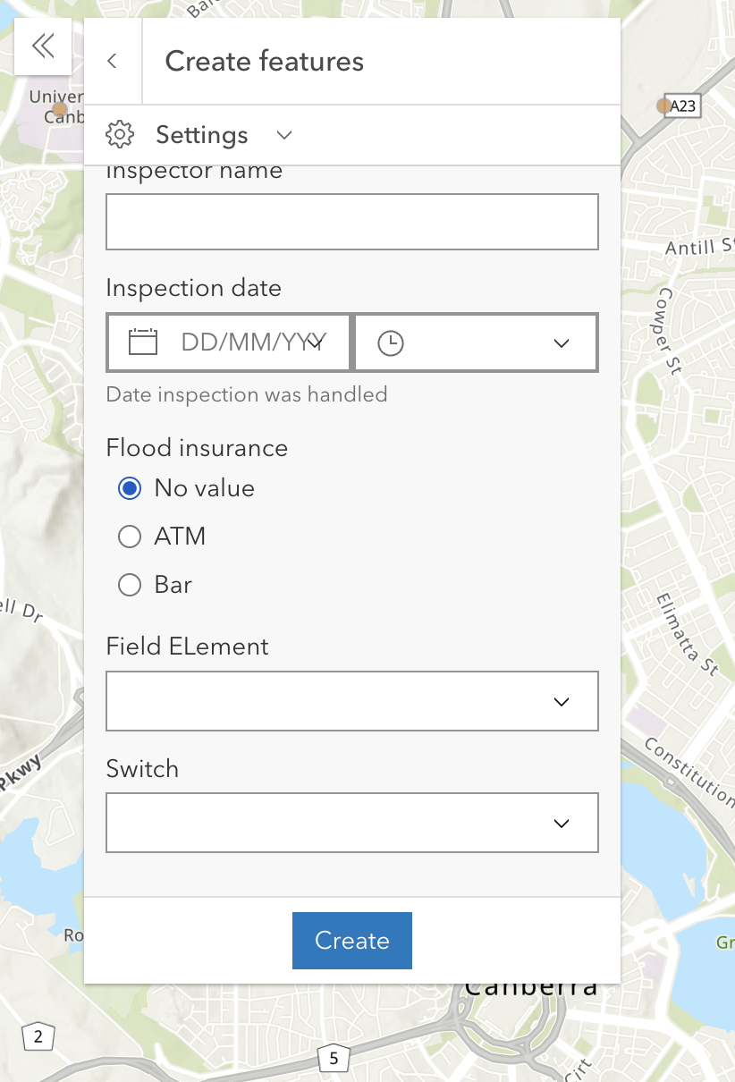

Hello,
I am trying to render switch input question in the editor widget, but I am able to see the dropdown question. Please let me know if I have missed something.
Please find the screenshot attached for the same
Below is the code that I have used

 const FieldElement6 = new FieldElement({
      fieldName: "fieldEt",
      label: "Switch",
     input: {
        type: "switch",
        offValue: "yes",
        onValue: "no"
const formTemplate = new FormTemplate({
      title: "Inspector report",
      description: "Enter all relevant information below",
      elements: [FieldElement6]
