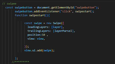

hello,
I open the swipe widget with the button function.
How can I turn it back off?
sample code
I want to turn the swipe widget on and off with a button.

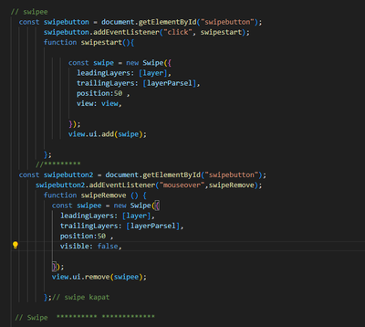

emreaktas1
My codes did not work as I wanted.
How can I edit here?

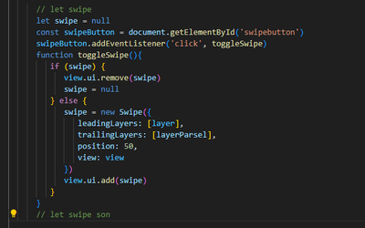

The way you have defined swipe is scope bound, so you are unable to call it again later. Try something like this.
let swipe = null
const swipeButton = document.getElementById('swipeButton')
swipeButton.addEventListener('click', toggleSwipe)
function toggleSwipe(){
   if (swipe) {
      view.ui.remove(swipe)
      swipe = null
   } else {
      swipe = new Swipe({
         leadingLayers: [layer],
         trailingLayers: [layerParse1],
         position: 50,
         view: view
      view.ui.add(swipe)
This should make a button that adds the swipe on the first click and removes it on a second click.

emreaktas1
On the second click the swipe widget was not removed completely.
It just works invisibly
