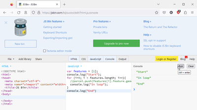

KenBuja
MVP Esteemed Contributor
It won't go through the loop once, though. In JSBin, this is what happens with your loop when features is not empty

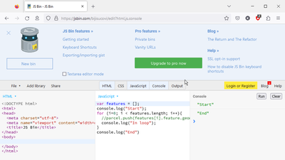

And this is when features is empty
