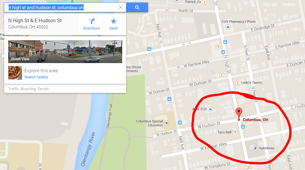

is there a streets intersection finder (geocoder) as in google map in the 3.12 API?
I am looking for something similar as on google map where the user types in two streets names and locate the intersection point:
ex: n high st and hudson st,

See this Locator | API Reference | ArcGIS API for JavaScript .
The list of fields included in the returned result set. This list is a comma delimited list of field names. If you specify the shape field in the list of return fields, it is ignored. For non-intersection addresses you can specify the candidate fields as defined in the geocode service. For intersection addresses you can specify the intersection candidate fields.

It's better to post the AMD link
JeffJacobson
The Geocoder dijit will do this. You separate the street names with an ampersand (&) character.
