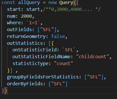

Do pagination query work only when orderBy is OBJECTID.
I am using a statistics query like below, where I want to run a count statistics on a total of 50k+ records.
I am trying to retrieve 2000 records per query using pagination. But the results are always returned for the first 2000 records.
Is there a way to do a pagination query for the statistics I am trying to achieve here?
