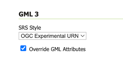

The more I look into this, the more I believe it might be an issue with our WFS service. There is a setting on our geoserver instance that lets us override the default GML attributes for WFS services.
Checking this box allows the name attribute to be returned. So, I don't think this is an issue with the arcgis mapping library at all, but rather with our lack of understanding of how geoserver works.
I appreciate your help, and we're going to continue our troubleshooting on the geoserver forums since that seems to be the root issue.

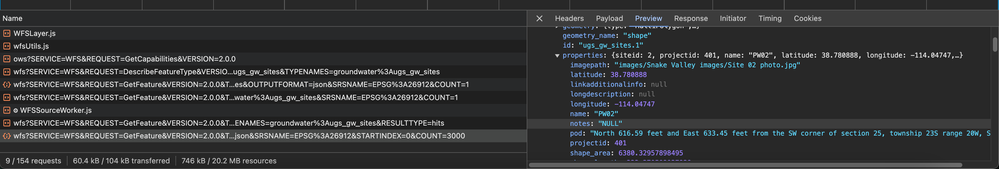

JayHill
the outFields was set on the wfsLayer as ["*"].  It seems as though that field/column gets lost when moves to the layerview. I see the attribute in the call to get the json from the endpoint.
Screenshot 2024-10-08 at 1.03.16 PM.pngScreenshot 2024-10-08 at 1.03.16 PM.png
