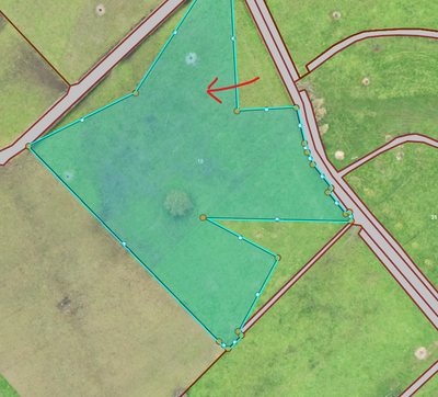

AliSultani
Hi @RalucaNicola , I'm still not able to modify the colour of the highlight graphic through the highlightOptions when using Sketch widget to update a graphic. e.g in the example below I want to change the blue colour to something else but not able to. Where is this graphic store in the map layers? I had look through all the layers but couldn't find the internal layer that the sketch is using.
