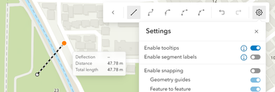

Right before clicking tab of the very first point:

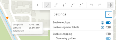

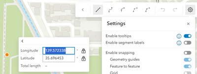

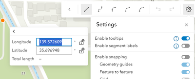

Right after clicking tab of the very first point:
It seems I only can set the coordinate by left clicking on the map after fixing the coordinates.
Hitting Enter only collapses the tooltip.
Right after left clicking the tooltip changes. It does not show coordinate tooltip any more, instead it shows deflection mode:
